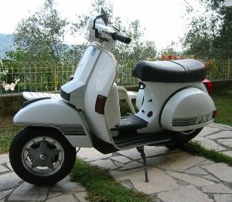

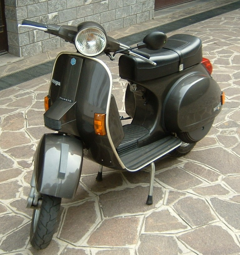

px_ant-sx_180.jpg.a340521dfd2ea661a0087a
px125_98mod.jpg.77e4c9f95f0317bdeb0f7e04
px_ant-sx_180.jpg.3abb4e33de870fd37063bd
px125_98mod.jpg.93d3baed4caebd43120179b0
px_ant-sx_180.jpg.63a15d4377b486fae2f756
px125_98mod.jpg.6d29dfe8cda59a2ab303b83d
px125_98mod.jpg.b5bf2961a48b45fcb5b229d8
px_ant-sx_180.thumb.jpg.1ea1e79df822b312
